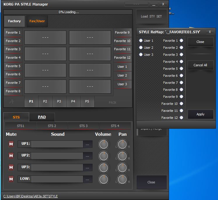

I try to merge my set with a Korg Pa 800 set into Pa Manager but when I click on Import/Merge it's freezing and hanging.
FYI, the Pa 800 set is unzipped.

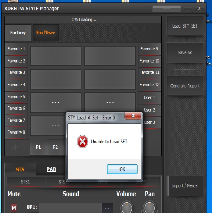

A) Does it freeze when you click the Import/Merge button, or when it's trying to load a set?
Answer: It freezes when it's trying to load a set.

As far as I can tell this set comes from a MAC system, because it has a lot of hidden duplicate Files that start with ._
Can you manually Delete all these duplicates from the Folders: i.e: ._FAVORITE01.STY

Ok, I deleted all hidden files (with extension ._) on entire set and sent it back to you.

Yes, off course (common sense.. :D ) I did but the same problem. That means the Korg Pa Manager still freezes on importing Pa 800 set.

There is no problem on my side loading the Set?! Everything is fine.
Can you load the SET on it's own? Not using the import/merge button?
