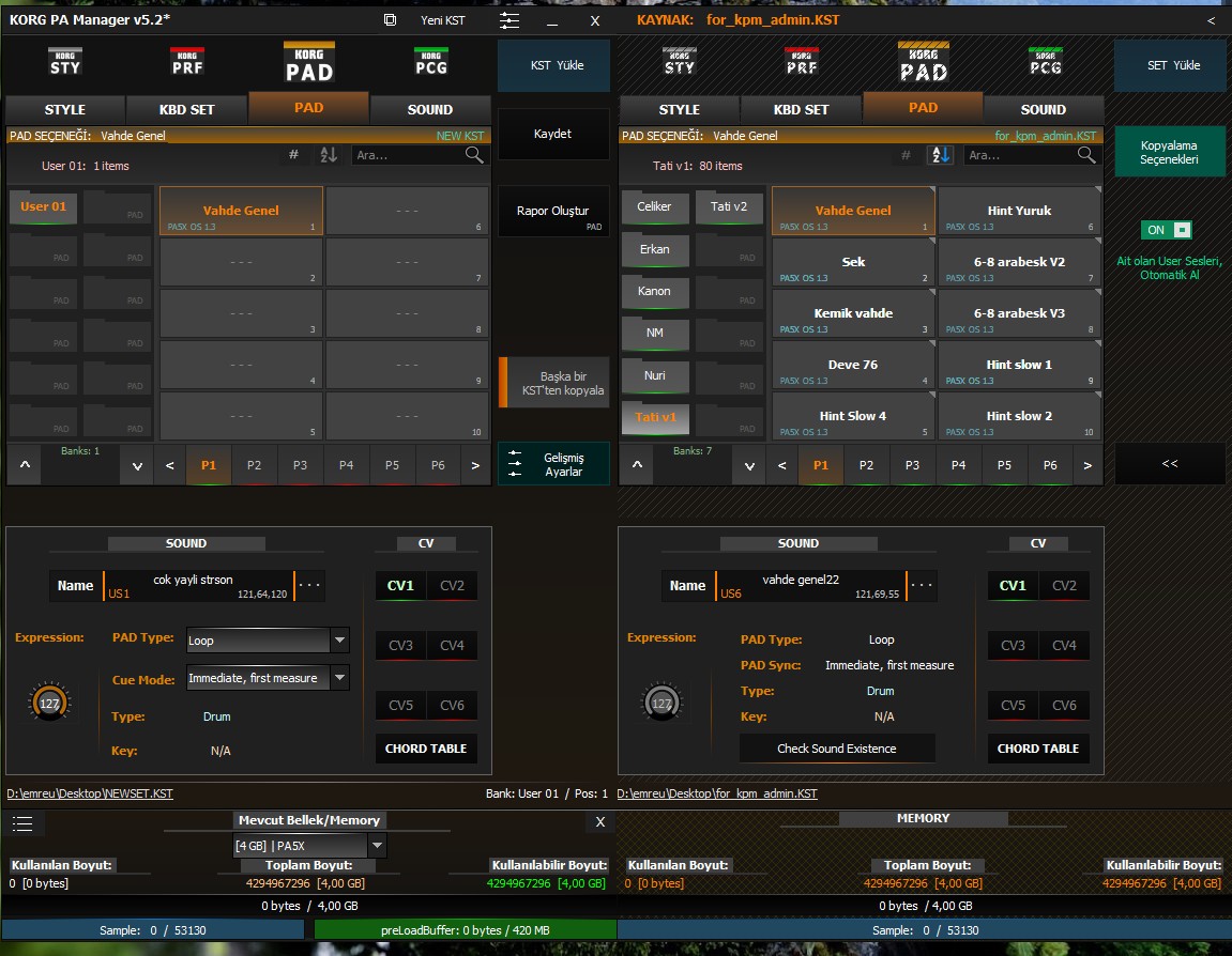

I did what you suggested and yes, I saw the issue as you described. However, there is one point I do not understand: is the pad now embedded into the rhythm? I thought it only referenced the pad section. I have attached screenshots of both the pad linked to the rhythm I wanted to transfer and the pad I saved as 'Save As Pad'. I would appreciate it if you could clarify this matter for me.

by Admin
With the PA5X, the PADs are now embedded inside the Style, just like a KBDSET. They have no reference to the PAD section or separate PAD files.

by emreuyar
Admin wrote: 20 Feb 2026, 18:36 Hi,
Thank you for your response. As far as I understand, at the moment there is no function in the software to edit a pad that is embedded into the rhythm. We can only edit it after saving it as a pad. However, the pad that is embedded within the rhythm is still considered as not edited.
