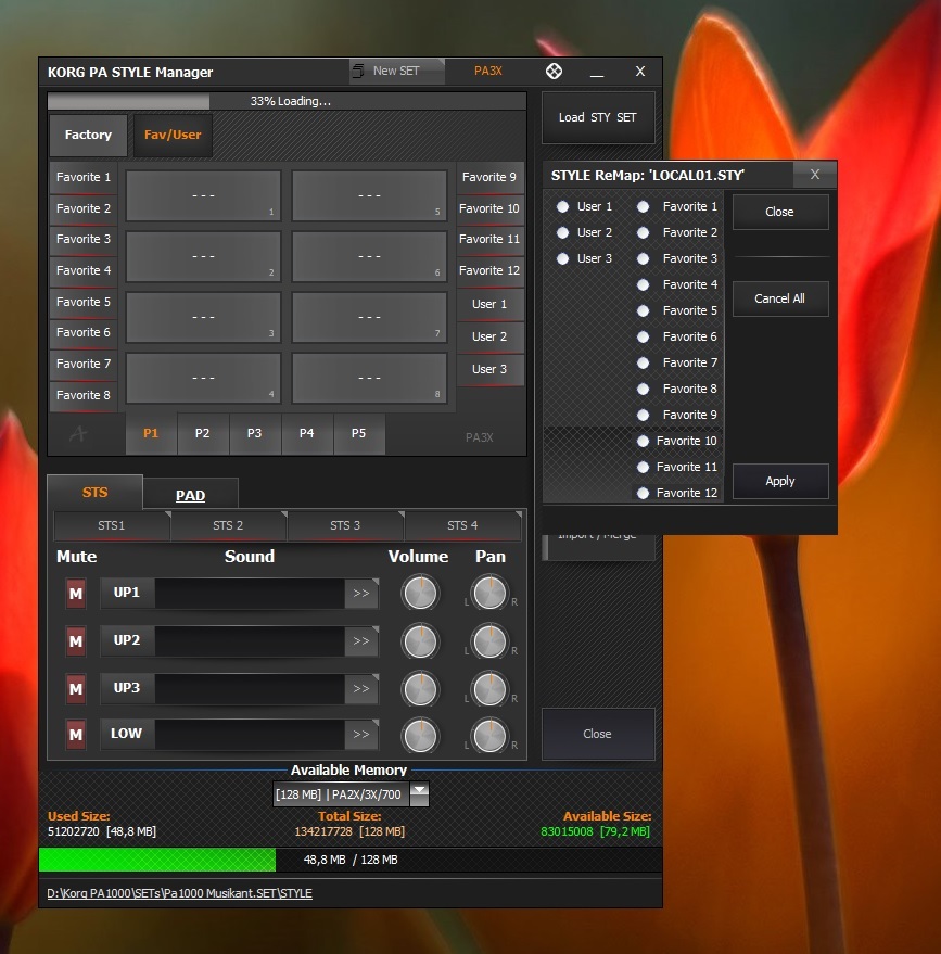

- Attachments
- Loading PA1000 Musikant_styles_set (styles are in orig local).jpg (192.47 KiB) Viewed 60036 times

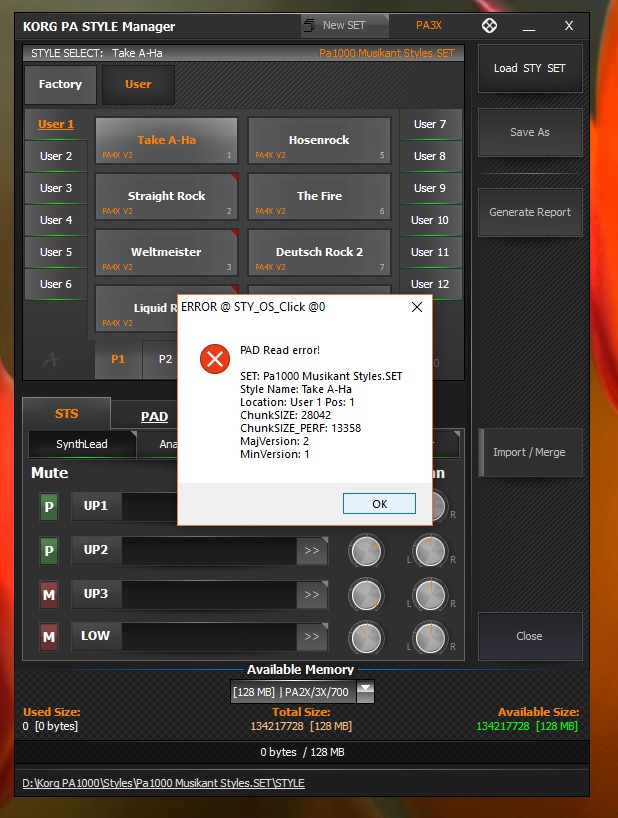

Now the styles are renamed as User.
- Attachments
- Reading PA1000 styles renamed as user styles.jpg (157.85 KiB) Viewed 60035 times

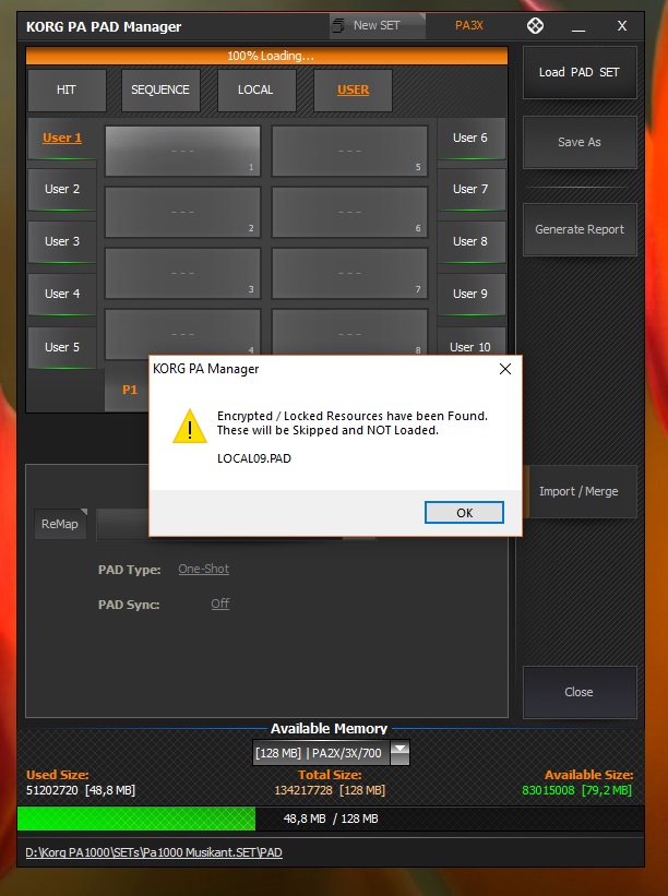

Now the Pads:
- Attachments
- Reading PA1000 Musikant Pads.jpg (132.24 KiB) Viewed 60034 times
Re: Korg PA manager and PA1000 musikant
And after renaming Local to user:
- Attachments
- Reading PA1000 Musikant Pads1.jpg (121.95 KiB) Viewed 60033 times

As you can see yourself, even after you've managed to load them, you'll still have errors, as the contents are Encrypted.
As much as I'd like to support Local files, it's something currently technically not possible due to encrypted content.
