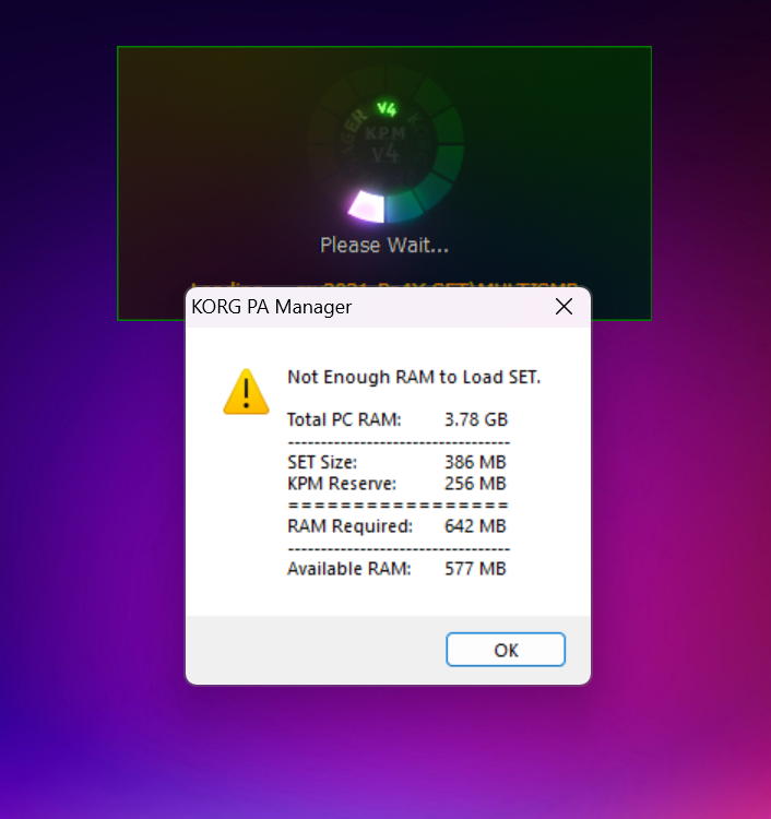

Problem:
I am getting an error message from KPM, please see screen shot.
My project:
I am trying to make a set from my Pa4x set for using on my Pa1000 (version 2024) in KPM.
I am using a laptop, Windows 11 with 4GB RAM.
I bought this laptop specially for using the Korg Pa Manager software, nothing else.
Pa 4X set size: 386 MB
Pa 1000 RAM available: 480 MB
After getting this error message I updated my Windows 11 yesterday 5/31/2025.
But I still get the same error message.
Please advise.
Thank you
KPM- Not Enough RAM memory

Re: KPM- Not Enough RAM memory
Hello,
Well, the message there is quite clear.
Your (4GB) PC seems to be almost filling up the RAM already.
The PC has only 577MB of Empty RAM left to use, but you're trying to load a SET that requires 642MB of use.
Windows itself is using 2GB+ of that 4GB RAM. Then you have other programs open in the background + KPM loading the SETs also.
You should try and close some programs from the background via the TASK Manager to empty and free some extra RAM.
